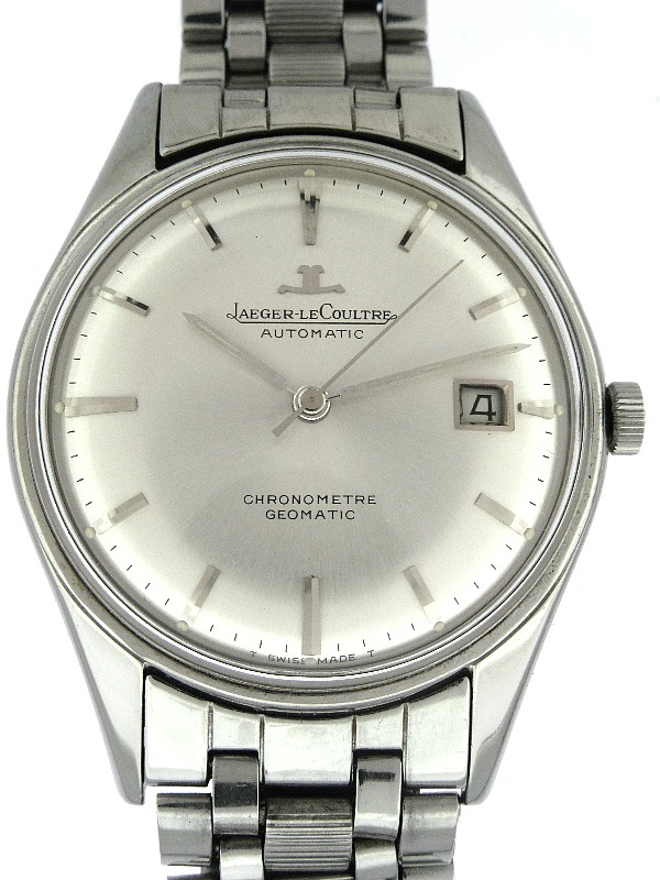

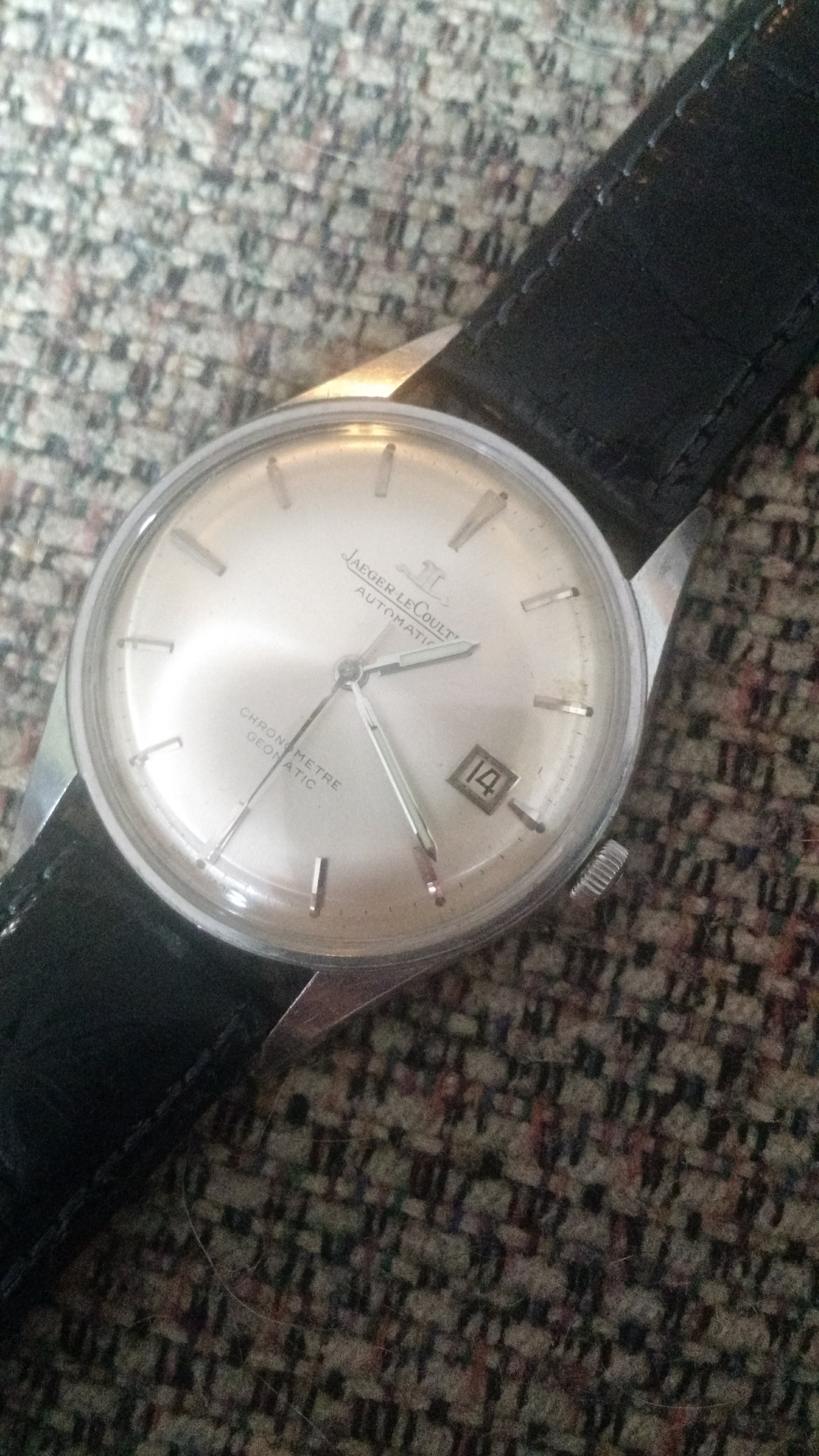

Thanks for your kind reply. I have attached an image of the Geomatic. I think the hands are not original. The style and length are incorrect. The lume is bright.

Yes, not correct. The cal 881/883 hands will fit and I'm pretty sure some no Geo dress watches have the same.

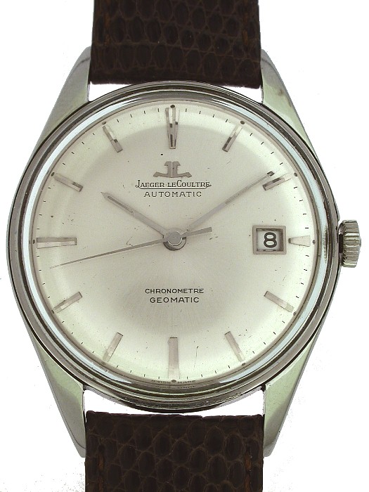

Check this:
Re: Geomatic hands
Postby zafbasha » Wed Mar 14, 2018 4:18 pm
And this:

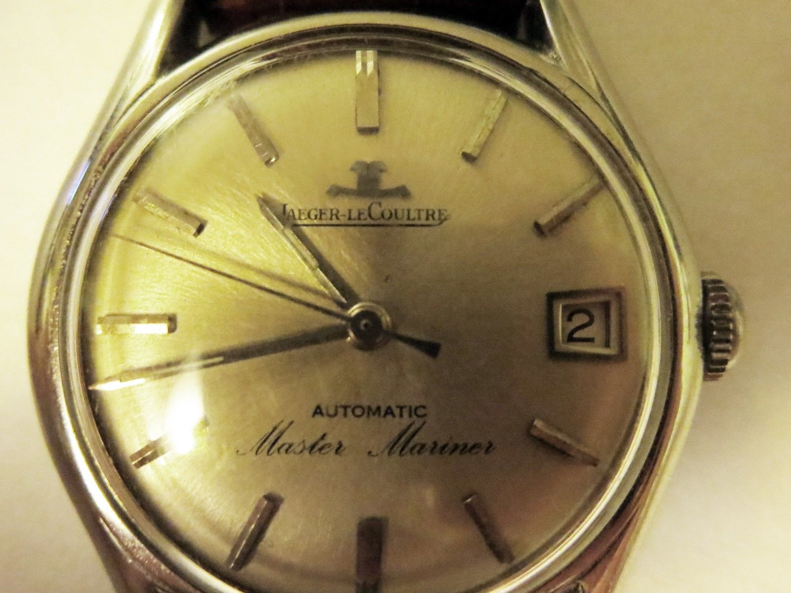

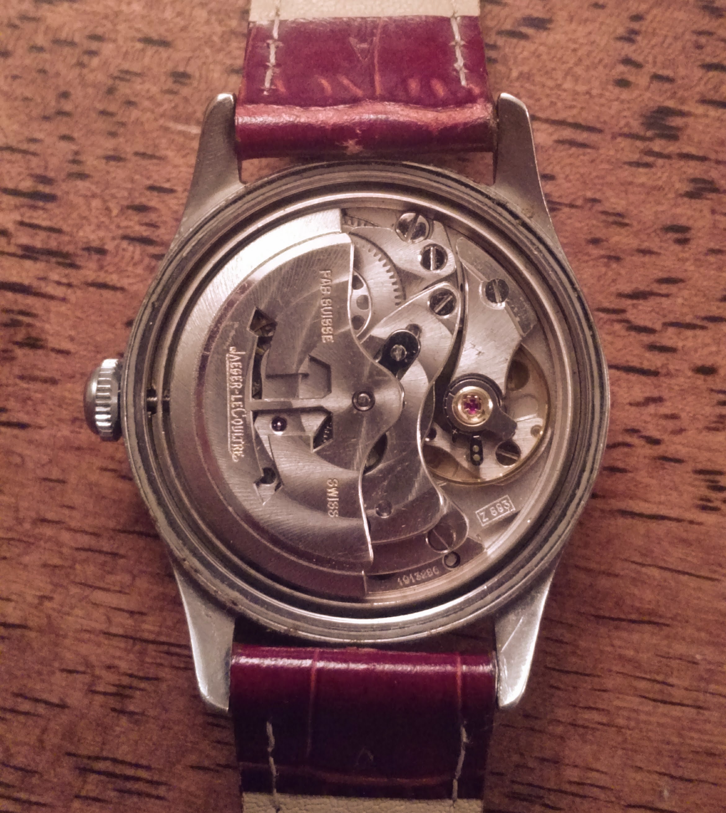

Here is a Master Mariner I own. Is this a K 883? The movement says "Z 883." Would these hands work as donors for the Geomatic? The case on this Master Mariner is about 33mm without the crown. I think the minute hand would be too short to reach the minute track of the Geomatic dial. Any opinions? I'm not sure I'd want to plunder the Master Mariner.
Also, the standard geomatic hands seem to have notches near the center,while these have none. See: http://www.shucktheoyster.com/wp-conten ... 28_003.jpg
