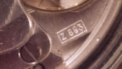

Thanks, Zaf. Below is a picture showing "Z883." The balance has kif shock protection, but it still says "z." I tried to research this "z883" and did not find much.
Thanks for letting me know about the hands and that they would fit (even from a "z"?). I'm not sure if I want to take apart this watch, what I'd then do with it, or if it is even advisable to do.

This is on the MM or Geomatic?
The Geo should be either a K881G or a K883G. The movement should hack set. Does yours hack set?
I've never seen a Z883 on a geomatic, though anything is possible I guess!

Hi Zaf,
Sorry for the confusion. Both movement pictures I have posted in this thread are of the Master Mariner.
It is the Master Mariner movement that reads "Z883." I cannot find much information on this movement.
My Geomatic does hack set. I can't open the back, so I can't post a picture. I have been researching Geomatic calibers here: https://www.watch-wiki.net/index.php?title=JLC_881
I thought the stainless steel Geomatic may be a K883 S. I'm confused by the possibilities.
