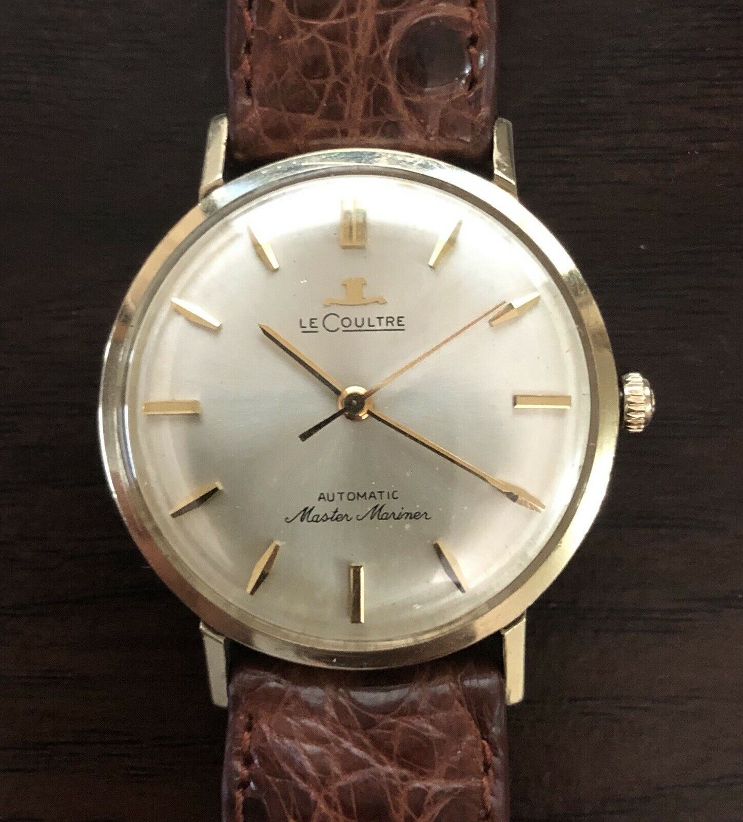

Postby DannyB » Wed Feb 12, 2020 4:32 am
Photo 4
The case is 14K gold.

Postby zafbasha » Sat Feb 15, 2020 8:44 am
I think it is OK, but the dial seems to be refinished.

Postby DannyB » Sun Feb 16, 2020 2:18 am
Thank you Zaf. It appears that you were correct- seller now discloses that it “ may have been refinished”. Disappointing but happy to find out now rather than later. So I know better next time, what made you question it? Thank you once again.

Postby zafbasha » Mon Feb 17, 2020 9:37 am
Everything about the script is a little sloppy. Also lacks Swiss/Swiss Made at 6:00.
