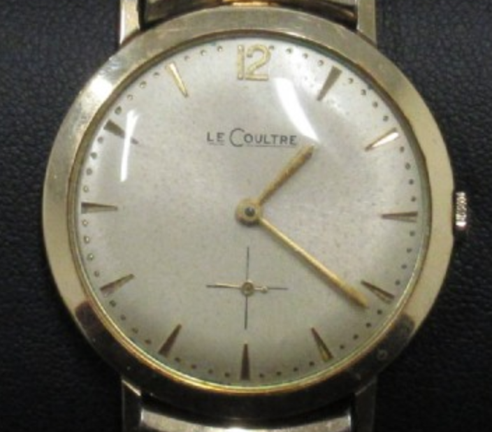

Hello all and thank you for the ad.
I'm from central Pennsylvania and I've been collecting watches for a number of years, primarily Omega, Longines & Movado. Lately, some classic pocket watches as well but I've never had a JLC until today.
I was wondering if anyone could offer information on a watch I bought recently. I have not yet received it so, unfortunately, I'm only able to post the pictures from the auction.
I'm not too familiar with the brand and only today realized there is a difference between Le Coultre and Jaeger Le Coultre. I've Googled "33mm 10K gold filled Le Coultre" but overwhelmingly the responses are in regards to the Memovox, very little information is available for other models.
This is not a "How much is it worth" post but rather I'd like to know what model it is and approximately what year it was produced.
Any thoughts would be greatly appreciated.
Thank you

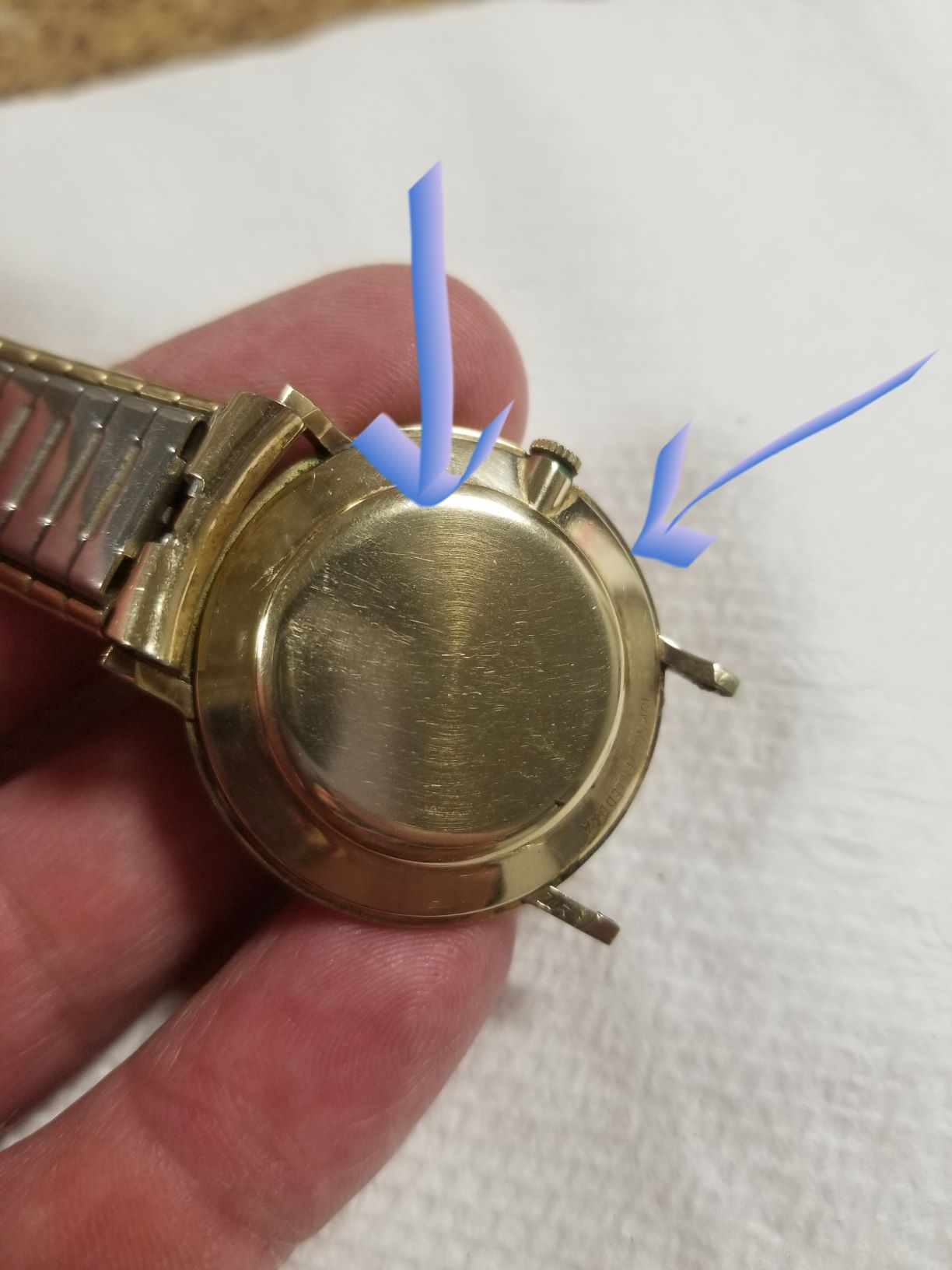

Zaf, the watch was delivered a day early. It's hard to tell if the case back will separate on the inner circle or the outer edge.
Any ideas?

Postby zafbasha » Thu Dec 10, 2020 8:29 am
If it says "use wrench XYZ" that usually indicative of a one-piece case. You'd need to remove the crystal and drop the movement out from the front.
Re: LeCoultre watch identification?
If not, it's the outer arrow that would be the pry point.

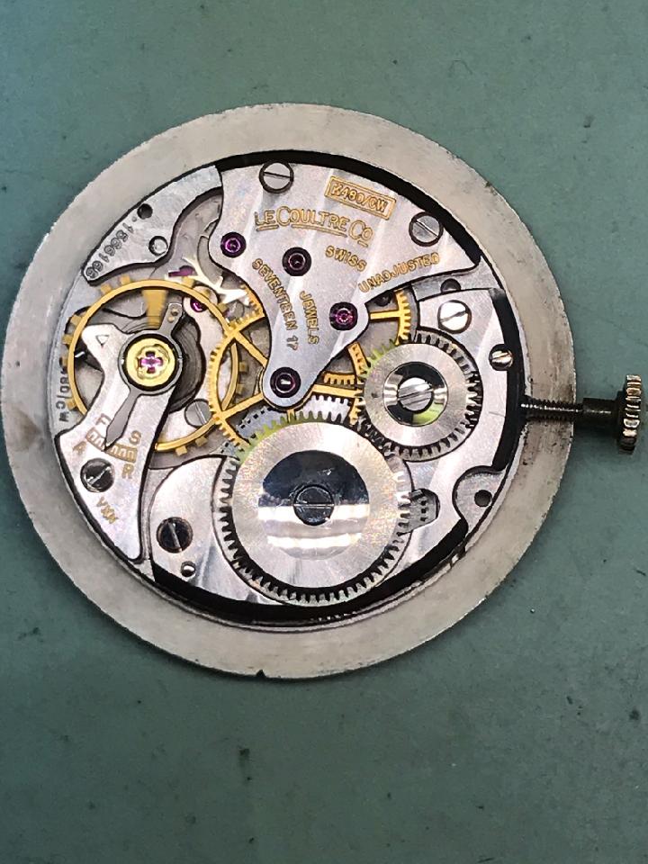

My watchmaker received the watch today and was able to send me a picture.
I am completely unfamiliar with JLC so the movement doesn't tell me much.
Do you recognize it?
Thank you again, your help and expertise is greatly appreciated.
Postby zafbasha » Wed Dec 16, 2020 12:05 pm
It's a caliber K480/CW, dates to about 1963.
