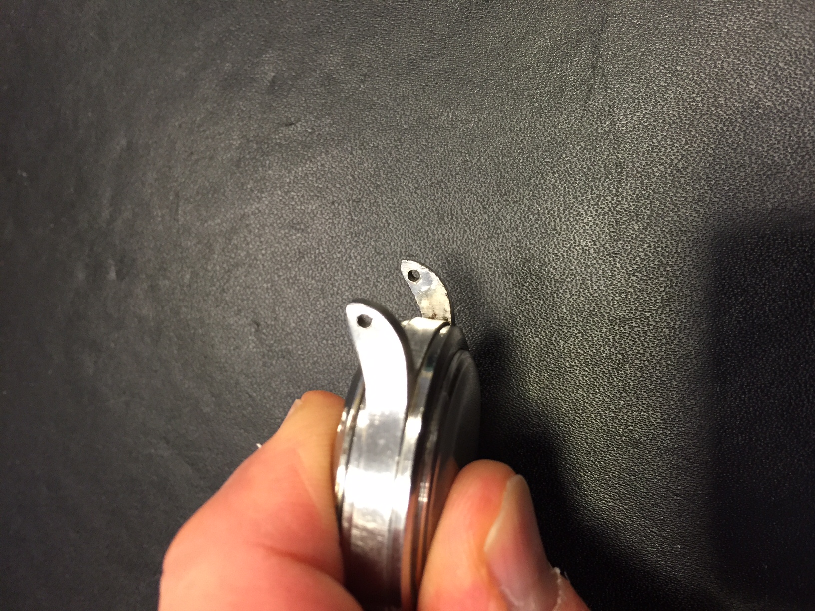

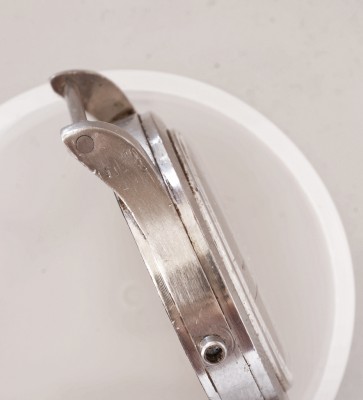

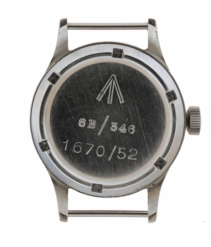

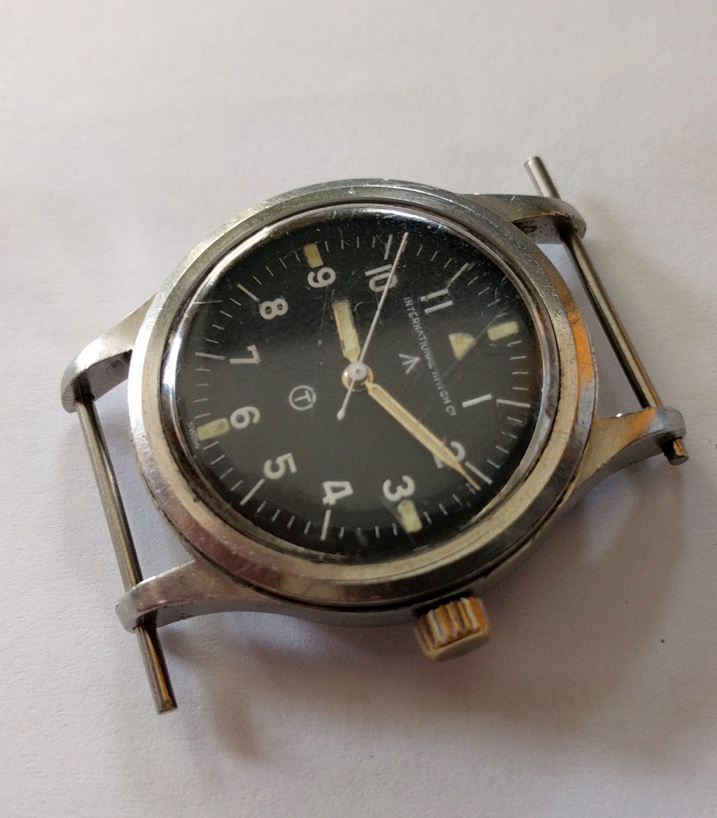

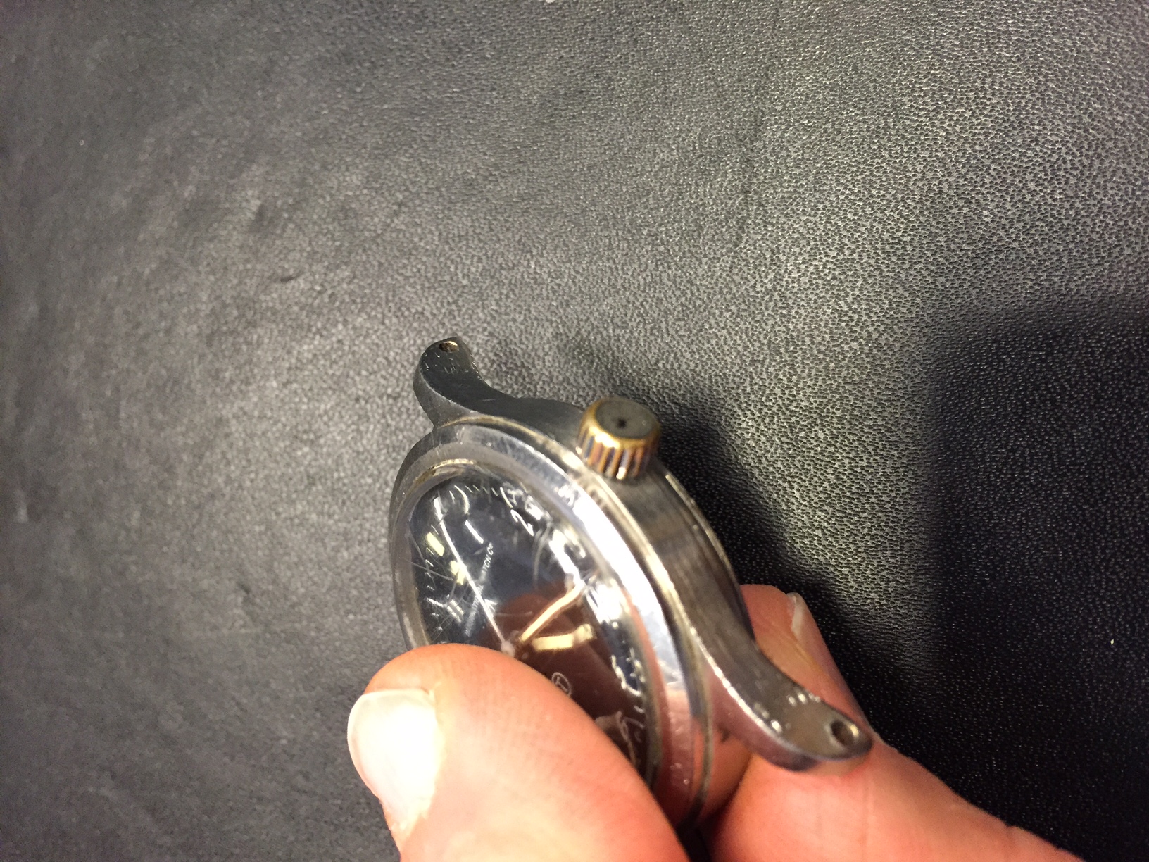

This will be a fun project, so I thought we'd do a little write up. This is how I received the watch today...
The watch had it's fixed bars drilled out, the wrong crown, a totally beat up crystal and is running sluggishly.
BUT ... lurking under there is a rather nice dial.
Stay tuned.

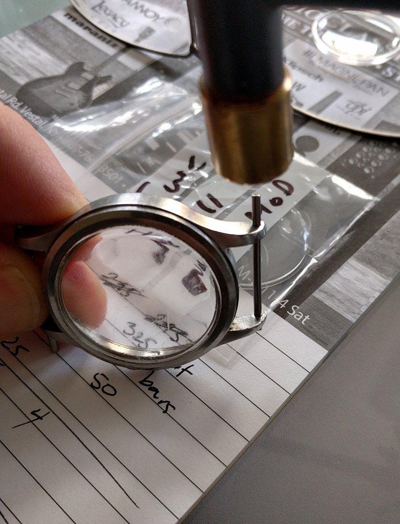

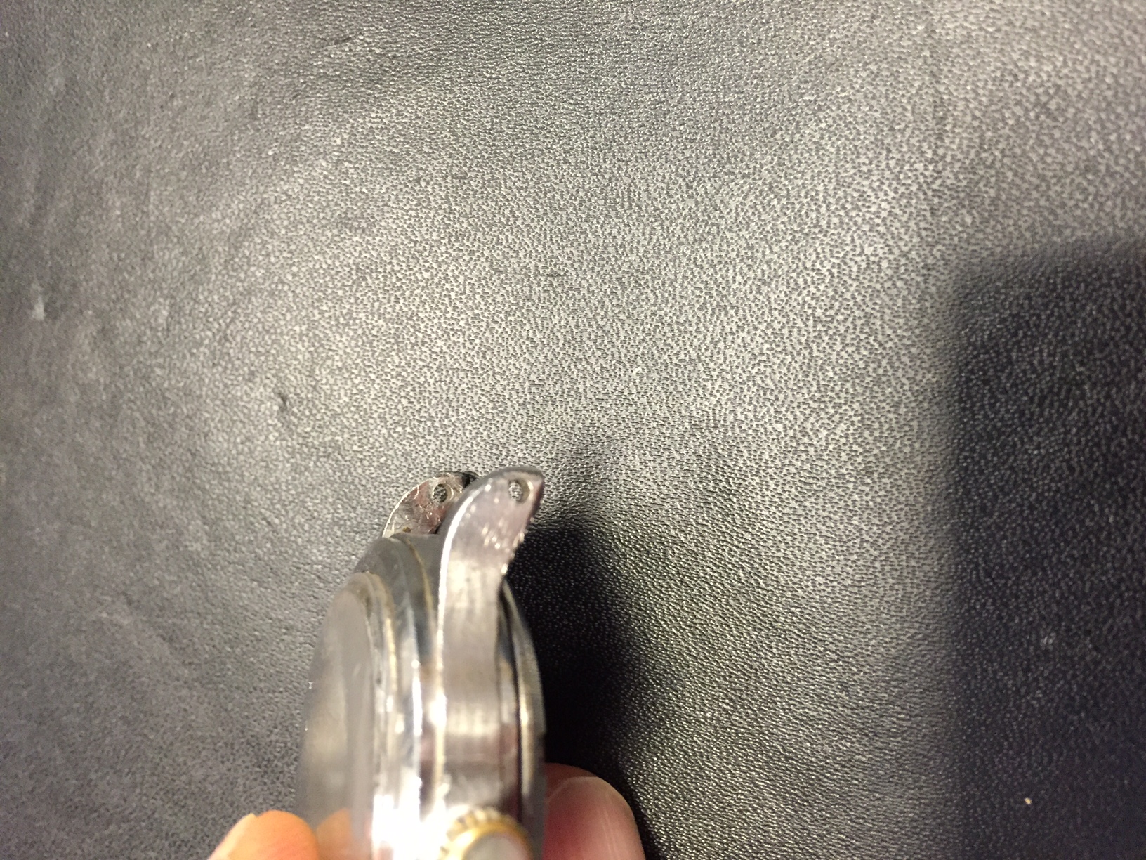

DAY 1:
A bit lucky, but I have in stock 1.5mm bars. Exactly the right size for a nice compression fit on the existing holes.
With the MOVEMENT OUT you can drive them into place. The driven side will mushroom out a little, which the side I will likely leave unsoldered.

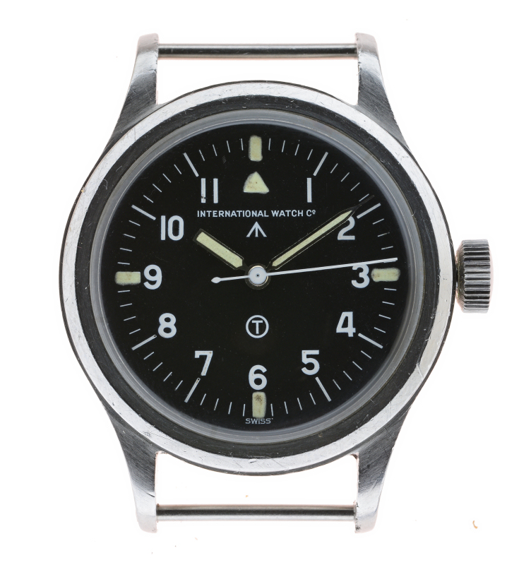

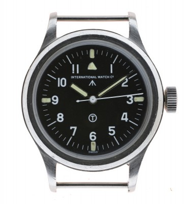

Post by zafbasha » Wed May 04, 2016 11:26 am
Here we go, back from a complete overhaul mechanically, NOS crystal and NOS crown. Not a bad result if I may so so myself!
