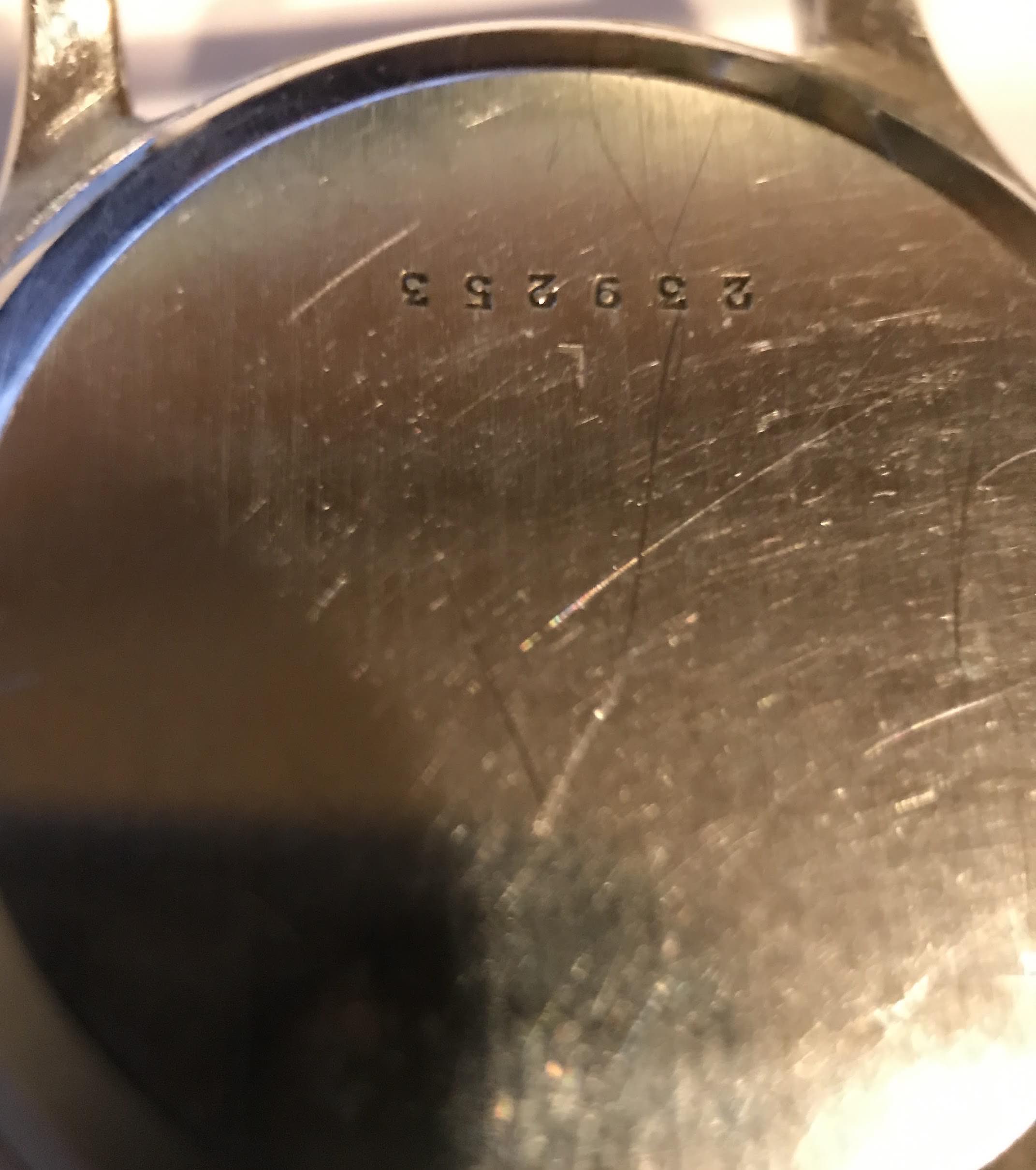

Postby trimobile » Mon Aug 14, 2017 8:15 pm
Here you go! it's on p478.
Posts: 584
Re: caseback number and letter
Postby zafbasha » Tue Aug 15, 2017 1:40 pm
Any chance of the inside markings?
trimobile
Posts: 19
Joined: Sat Oct 08, 2016 10:33 pm

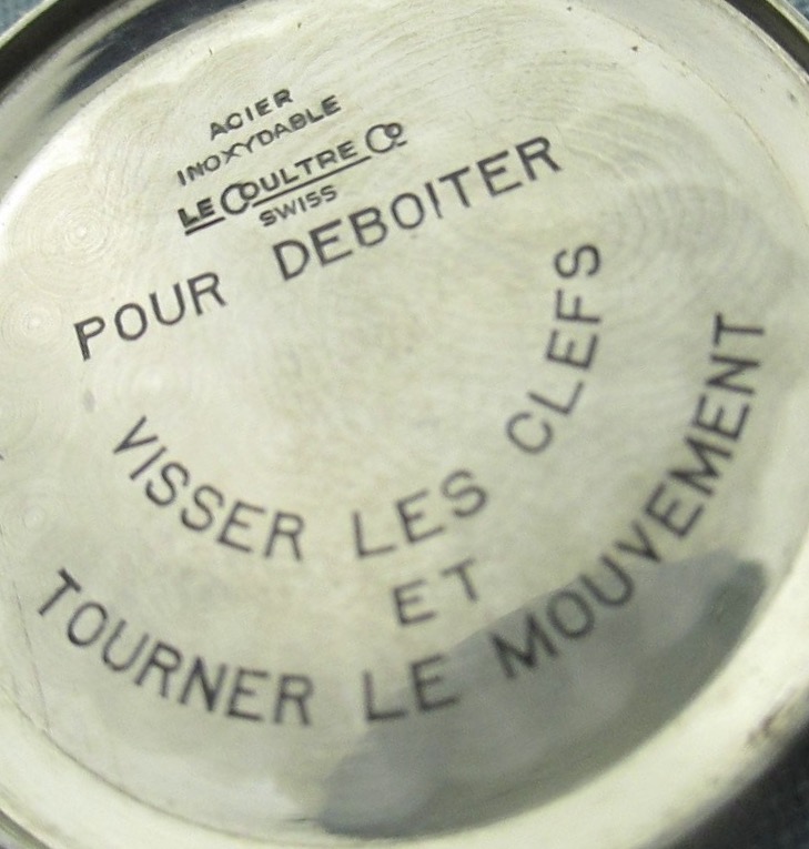

Postby trimobile » Wed Aug 16, 2017 9:24 am
Here's the reverse side
Posts: 584
Postby zafbasha » Wed Aug 16, 2017 10:33 am
So what do you think the top is made of? That "L" looks pretty faint. I'm not sure what it means.
On plated tops, the back usually says "Fond Acier Inoxydable" i.e. stainless steel BACK.
trimobile
Posts: 19
Postby trimobile » Wed Aug 16, 2017 6:50 pm
There is no pitting and the lugs are sharp. I think the case is SS.
The L is rare and a bit of a mystery. I have trouble understanding why someone would mark it L. It does seem somewhat faint but I think that's due to the way I took the picture and some of the examples I have that have B are fainter and more smudged from polishing.
